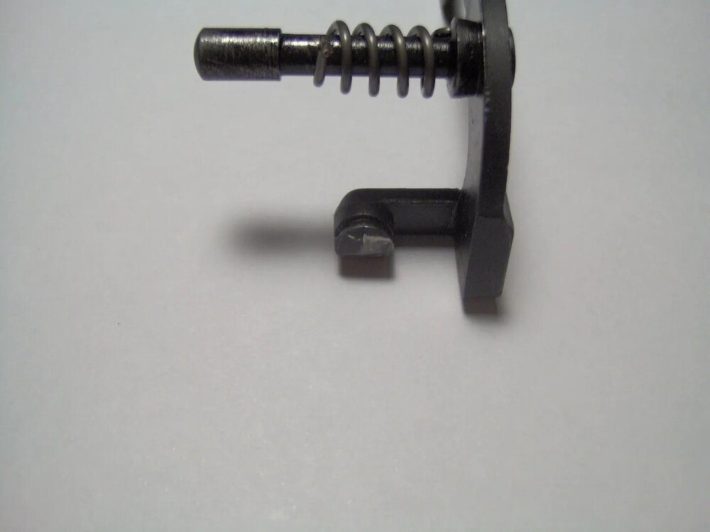

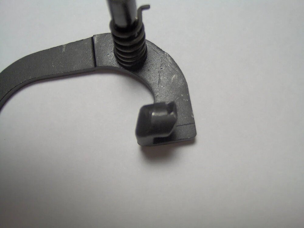

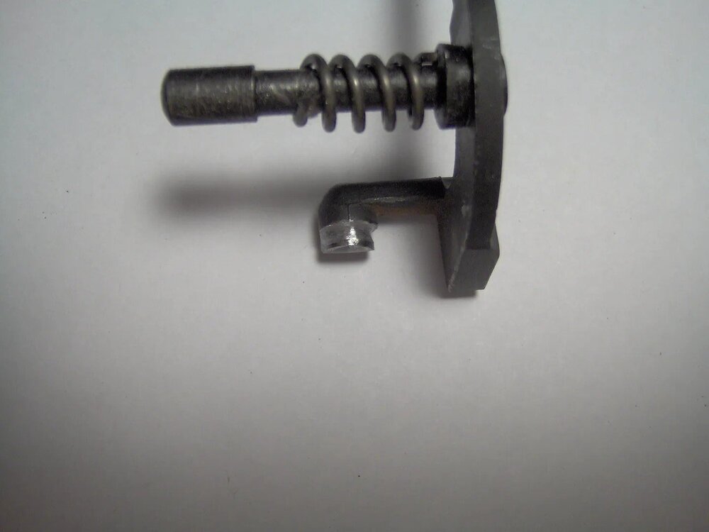

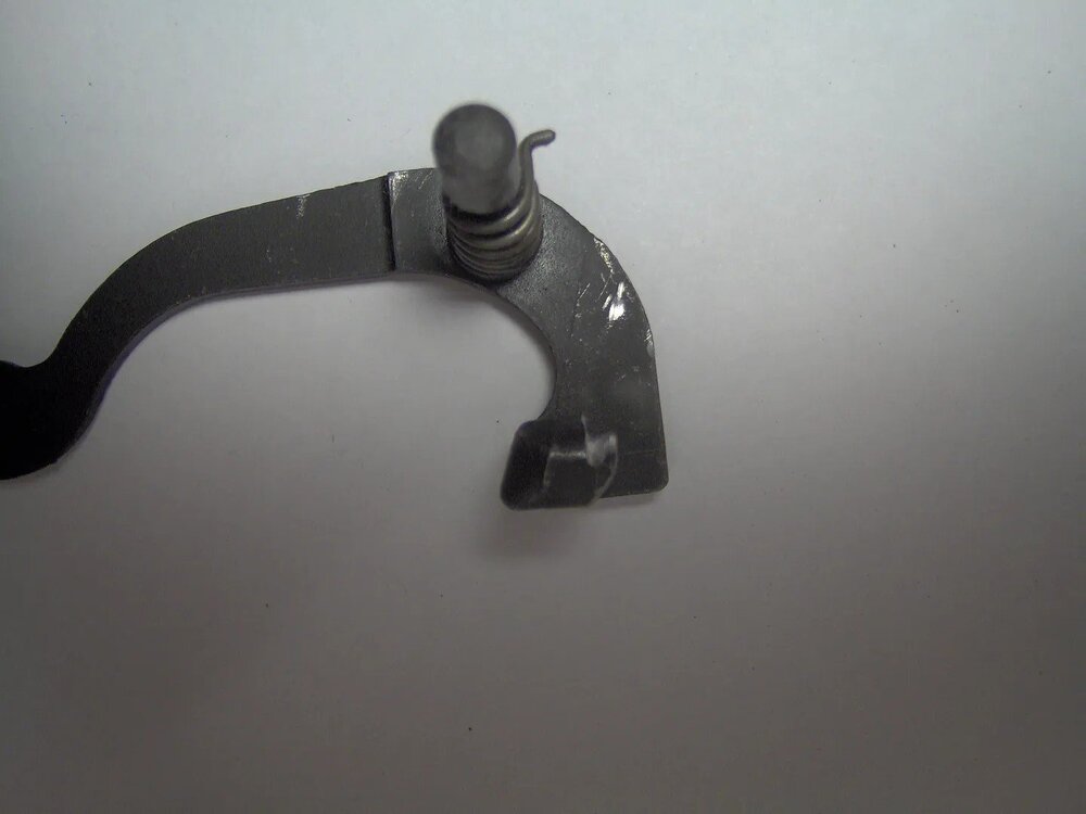

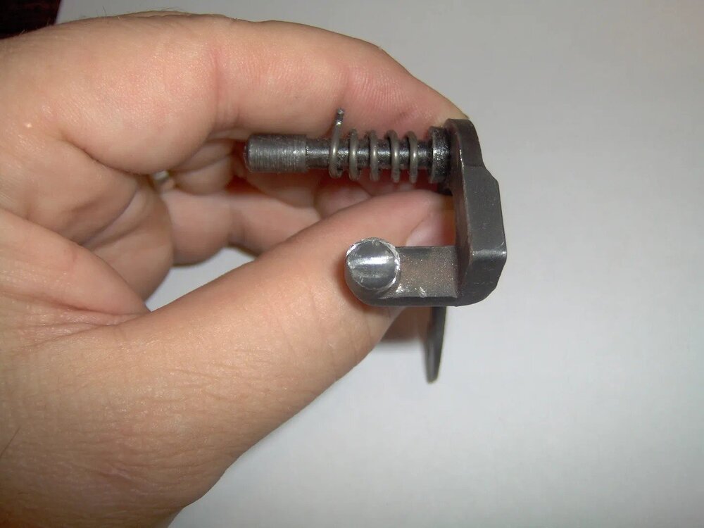

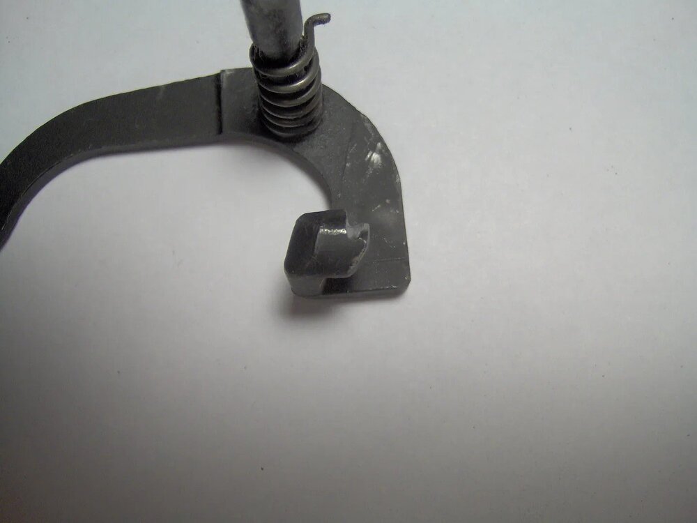

ghostsoldier Posted June 23, 2012 Report Share Posted June 23, 2012 It's not that hard, just a bit time-consuming, as you have to test-fit it repeatedly to make sure it works. Here's the some-what blurry before-and-after pics of mine; I used a Dremel to do it....you're basically just deepening the catch notch. BEFORE http://img.photobucket.com/albums/v629/ghostsoldier/My%20Impression%20stuff/My%20Weapons/BEFORE1.jpghttp://img.photobucket.com/albums/v629/ghostsoldier/My%20Impression%20stuff/My%20Weapons/BEFORE2.jpg AFTERhttp://img.photobucket.com/albums/v629/ghostsoldier/My%20Impression%20stuff/My%20Weapons/AFTER1.jpghttp://img.photobucket.com/albums/v629/ghostsoldier/My%20Impression%20stuff/My%20Weapons/AFTER2.jpghttp://img.photobucket.com/albums/v629/ghostsoldier/My%20Impression%20stuff/My%20Weapons/AFTER3.jpghttp://img.photobucket.com/albums/v629/ghostsoldier/My%20Impression%20stuff/My%20Weapons/AFTER4.jpg Hope these help. Rob 1 Link to comment Share on other sites More sharing options...

SecondAmend Posted September 23, 2012 Report Share Posted September 23, 2012 To get the catch modification to hold reliably on most of the unmodified mags that I have, I had to grind down slightly more (about 1/2 mm) than shown in the 'ghostsoldier' photos. And I have a few Crosby mags (known to have out of spec issues) that do not reliably hold even with the additional material removal. All the non-Crosby and some of the Crosby latch and hold. It took about five tries of only removing a little at a time to get to get the modified catch to "catch". Best of luck with your project. 1 Link to comment Share on other sites More sharing options...

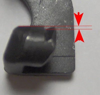

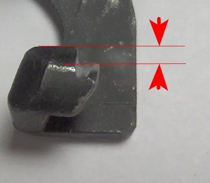

Jim W Posted April 17 Report Share Posted April 17 As the photos in the post by Ghostsoldier no longer seem to show, I am taking the liberty of redoing his post, with the photos that were still hosted on Photobucket, but no longer link: It's not that hard, just a bit time-consuming, as you have to test-fit it repeatedly to make sure it works. Here's the some-what blurry before-and-after pics of mine; I used a Dremel to do it....you're basically just deepening the catch notch. BEFORE AFTER Hope these help. I also thought these markups might help: Before: After: Link to comment Share on other sites More sharing options...
