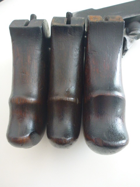

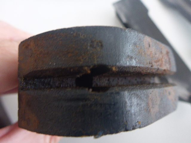

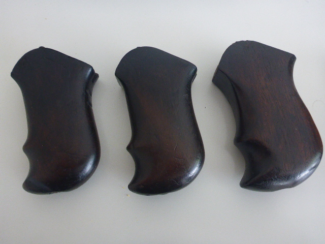

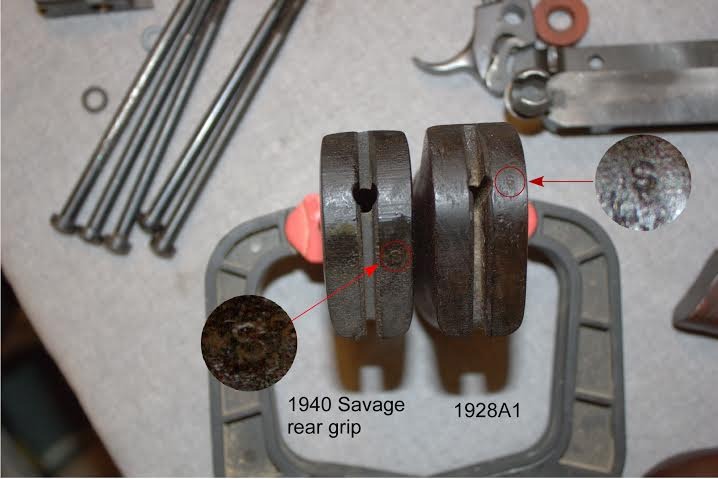

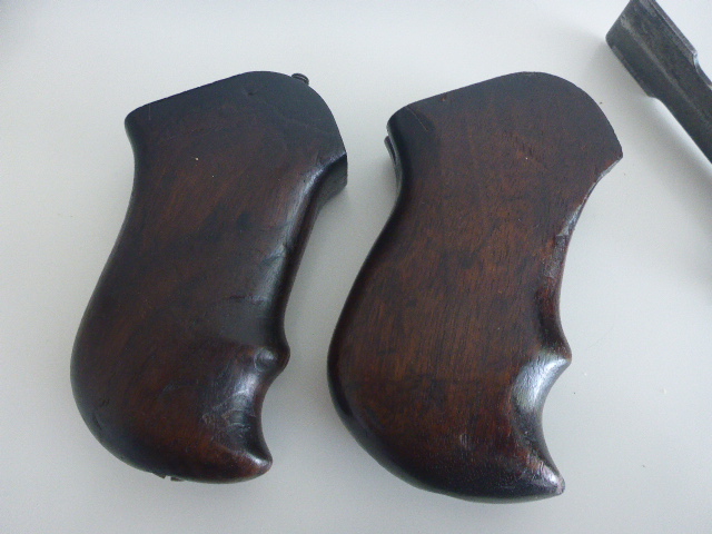

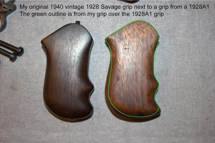

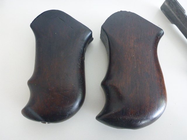

rpbcps Posted May 24, 2017 Report Share Posted May 24, 2017 Any excuse to play with 'my toys', as the wife calls them. This morning I took some pictures of the pistol grips, side by side, of my 3 digit 1921, Savage 1928 SN 18344 and 'TOMMY GUN' Stamped US19218A1 SN 162650. The only grip which appears to have any markings is the US1928A1, which has an 'S' stamped in the area usually hidden, when attached to the trigger frame. 1921 is on the left, Savage1928 centre and US1928A1 on the right, the US1928A1 looks 'larger' than the 1921 and the Savage 1928. Below are some other photos showing the 1921 (left) next to the US1928A1 (right). In my files I have the comparison photos below, showing the difference between an early Savage 1928 and Savage US1928A1. I am sure these two photos were downloaded from this forum in the past, so I hope the member who originally posted them, does not mind me adding them to this reply. You can see the same differences on my 1928 and US1928A1 in the 'threesome' pictures above, although there is no 'S' stamp on my Savage 1928. I hope these photos are of some help to you. Stay safe Richard Link to comment Share on other sites More sharing options...
1952HRA Posted May 24, 2017 Report Share Posted May 24, 2017 Richard the M (strombeck-becker) mark on your 1928 grip could just be no longer visible!? The Savage grips I've seen tend to be a wider flatter grip as shown in your picture, all the strombeck-becker grips I've seen tend to be a smaller more rounded grip like the 1928 and 1921 shown in your picture, I thought all savage and AO guns had grips and stocks made by savage, strombeck-becker or Dittenborn, if I'm wrong please correct me Link to comment Share on other sites More sharing options...

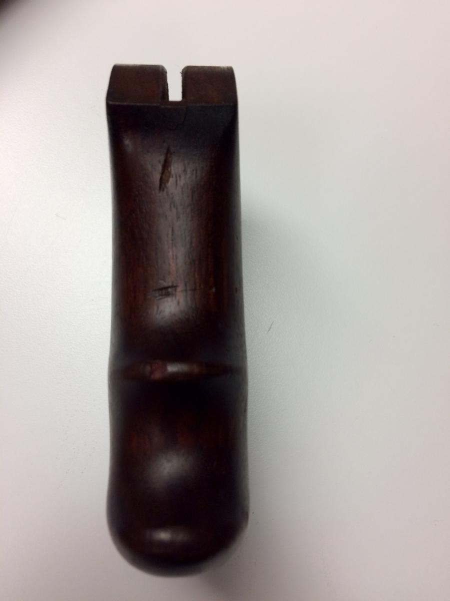

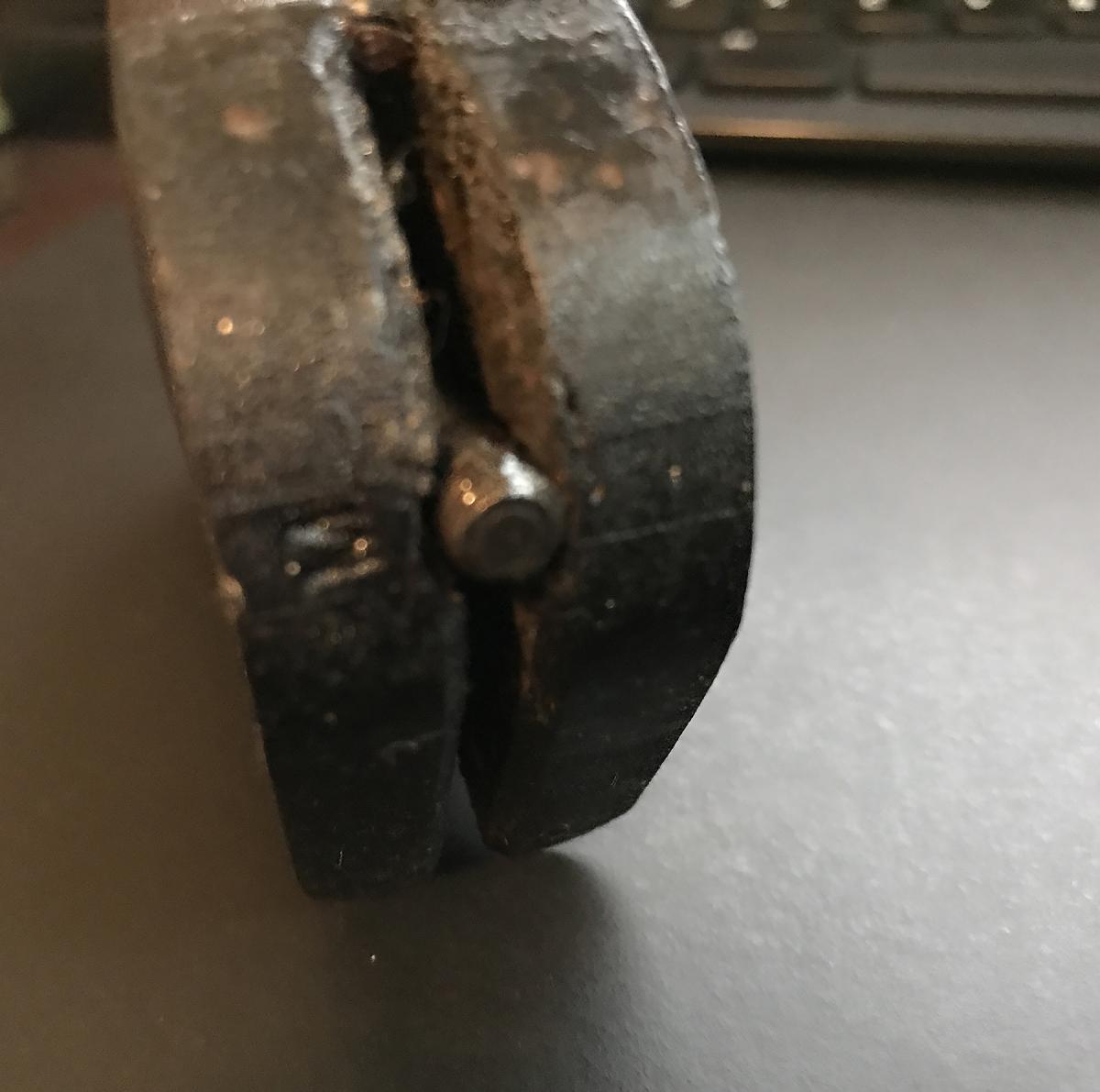

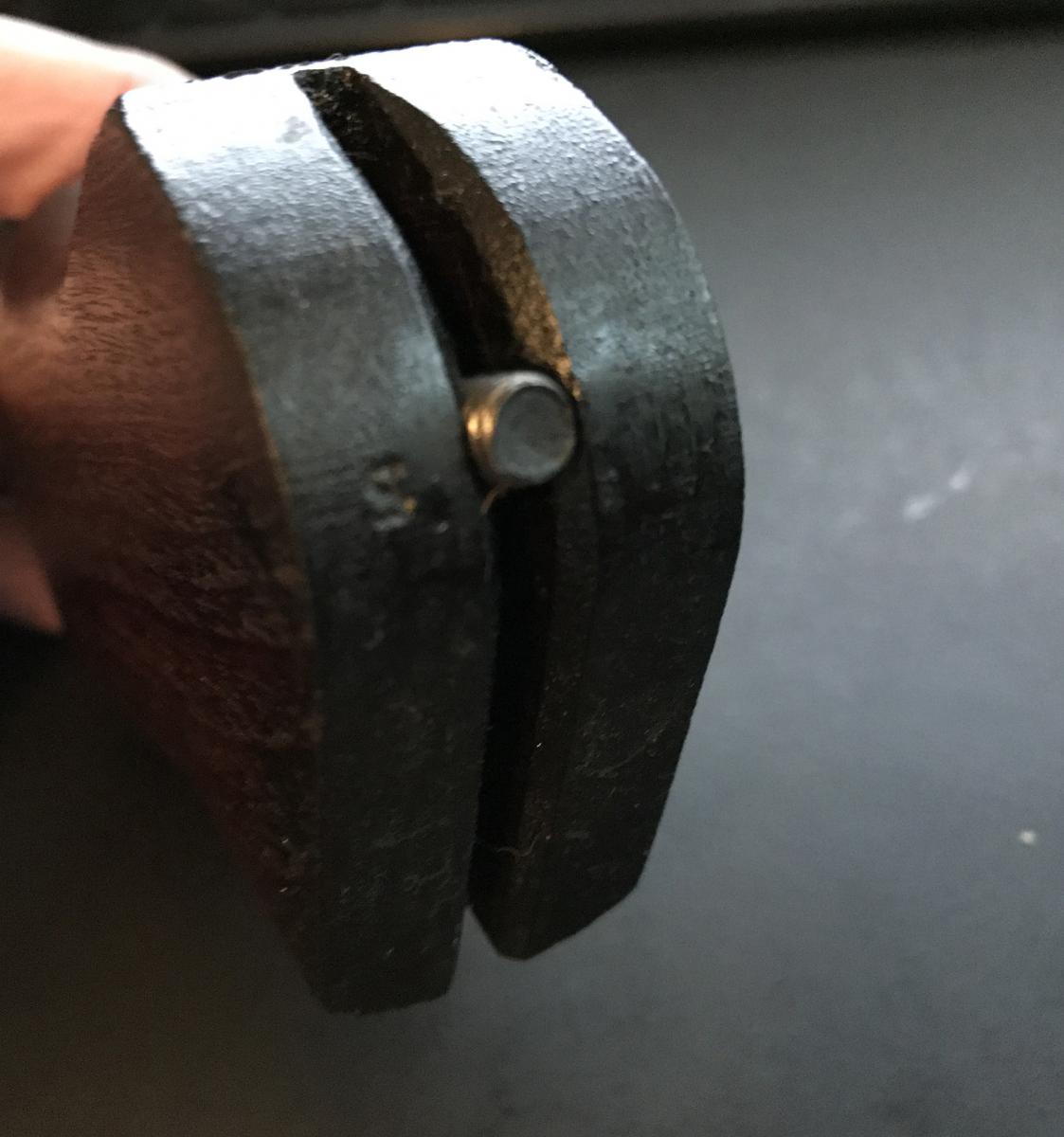

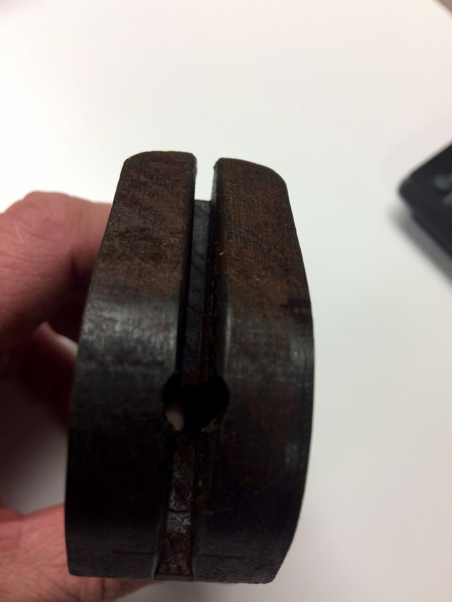

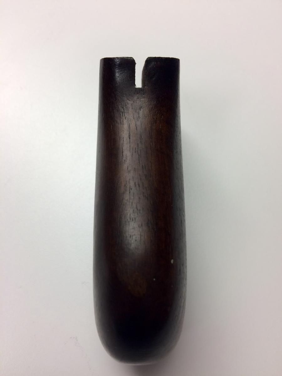

Joseph_T Posted May 24, 2017 Author Report Share Posted May 24, 2017 (edited) Thanks alot!! wow these look beautiful!! i would like to have these toys. how were they making this thick dark color? by the way, question is, i have met today a guy which in his collection have a 1928a1, and straight away i noted his rear grip. it looks much different and more beautiful in terms of design and size compared to standard 1928a1 grips (who looks more a similar to rocks than grips imho) and feels alot different when handled. Is this coming from a 1921?? he swear it was with the gun when he bought it. Well, cause if its from a 1921 im gonna make him a offer he cannot refuse My phone is camera its literally on its way to the cementery sorry for bad quality picture. P.s the bottom screw cavity seems like slightly smaller and the bolt head wont fit unless really forced. (maybe too precise for 1928a1 bolts?!) http://i63.tinypic.com/6fz7s6.jpg Edited May 24, 2017 by Joseph_T Link to comment Share on other sites More sharing options...
bug Posted May 24, 2017 Report Share Posted May 24, 2017 (edited) The horizontal travel of the wood at the base of the trigger guard is typical of the Colt grip. I have never seen one that pronounced and obvious before. I do see variations of this feature in photos but I'm sure lighting and photo angle can vary the effect. I hope Gijive, our resident Gripologist, weighs in here. Bob D Edited May 24, 2017 by bug Link to comment Share on other sites More sharing options...
Joseph_T Posted May 24, 2017 Author Report Share Posted May 24, 2017 Yes the picture it is a bit distorting the view of the item in reality, its not actually that straight, this saturday i should be back at north so i can take some more pictures.. and if we get an approval that this is a 1921 grip i will try to buy it aswell. Link to comment Share on other sites More sharing options...

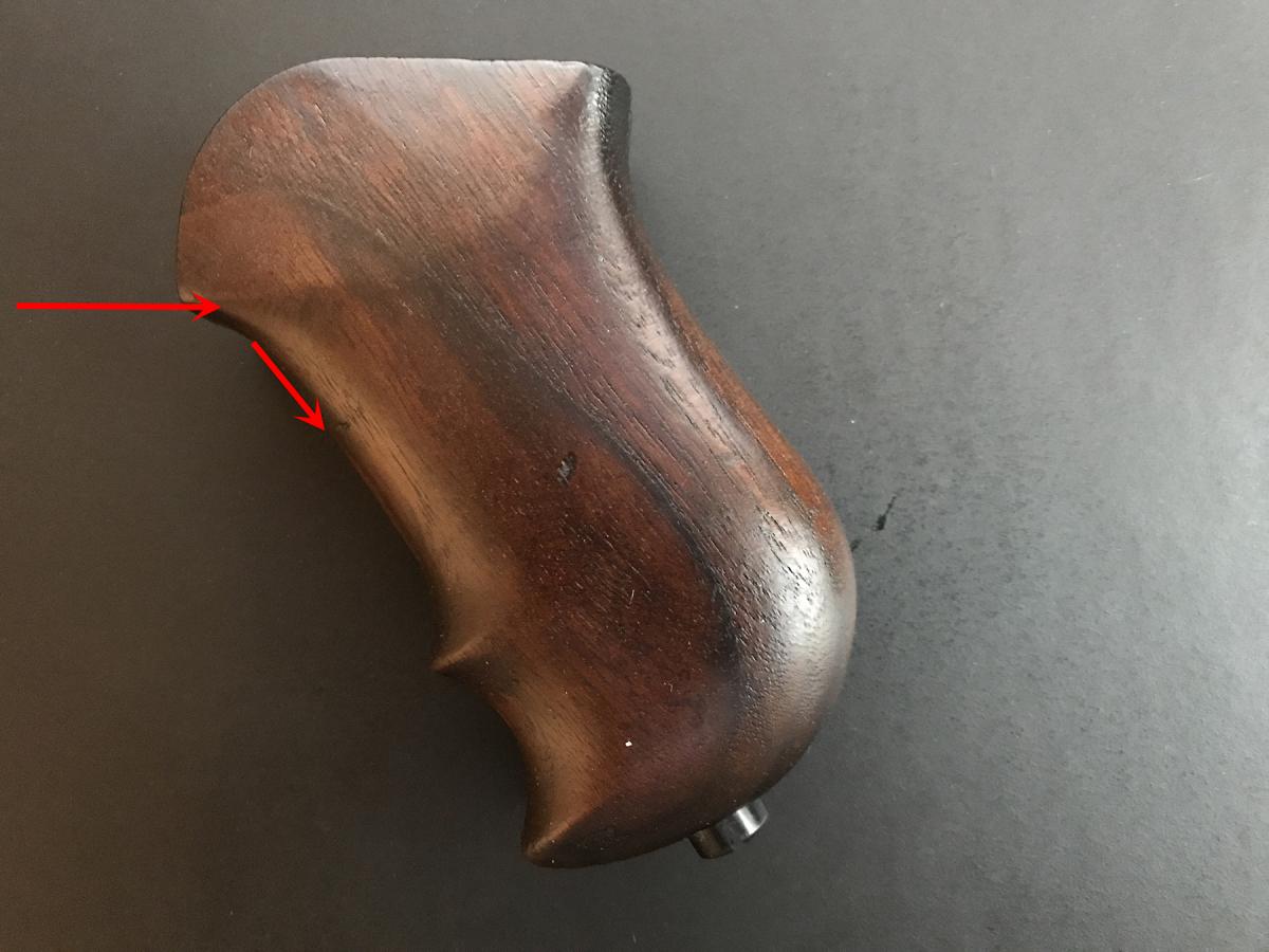

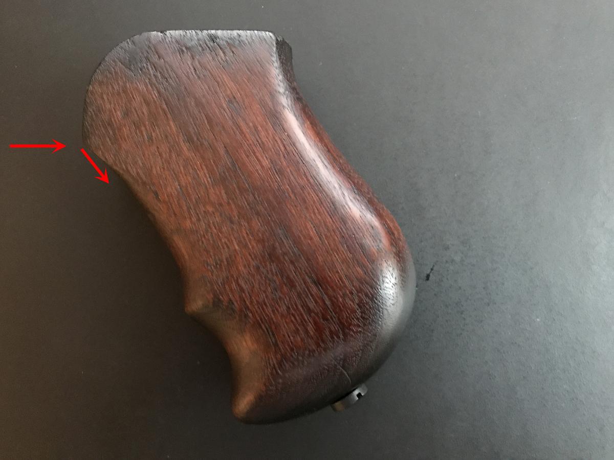

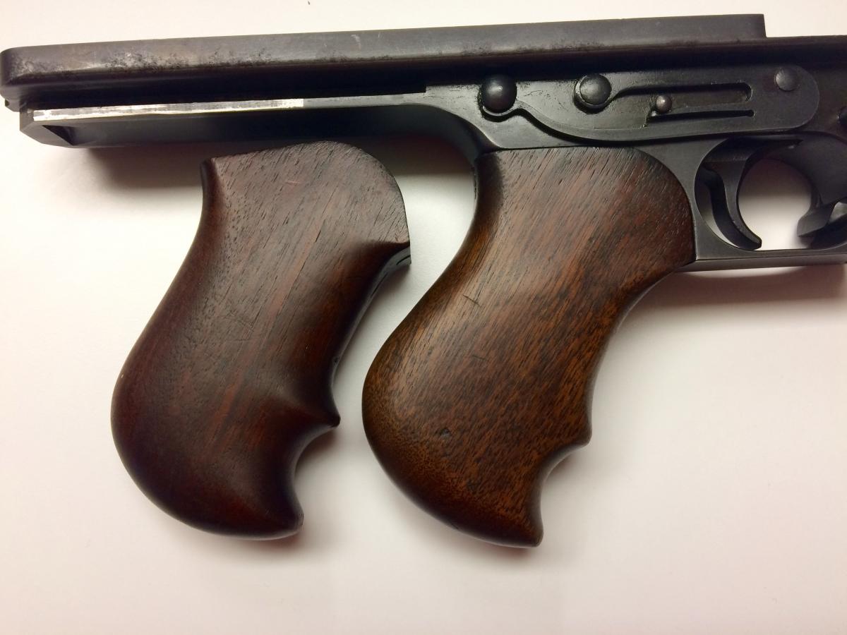

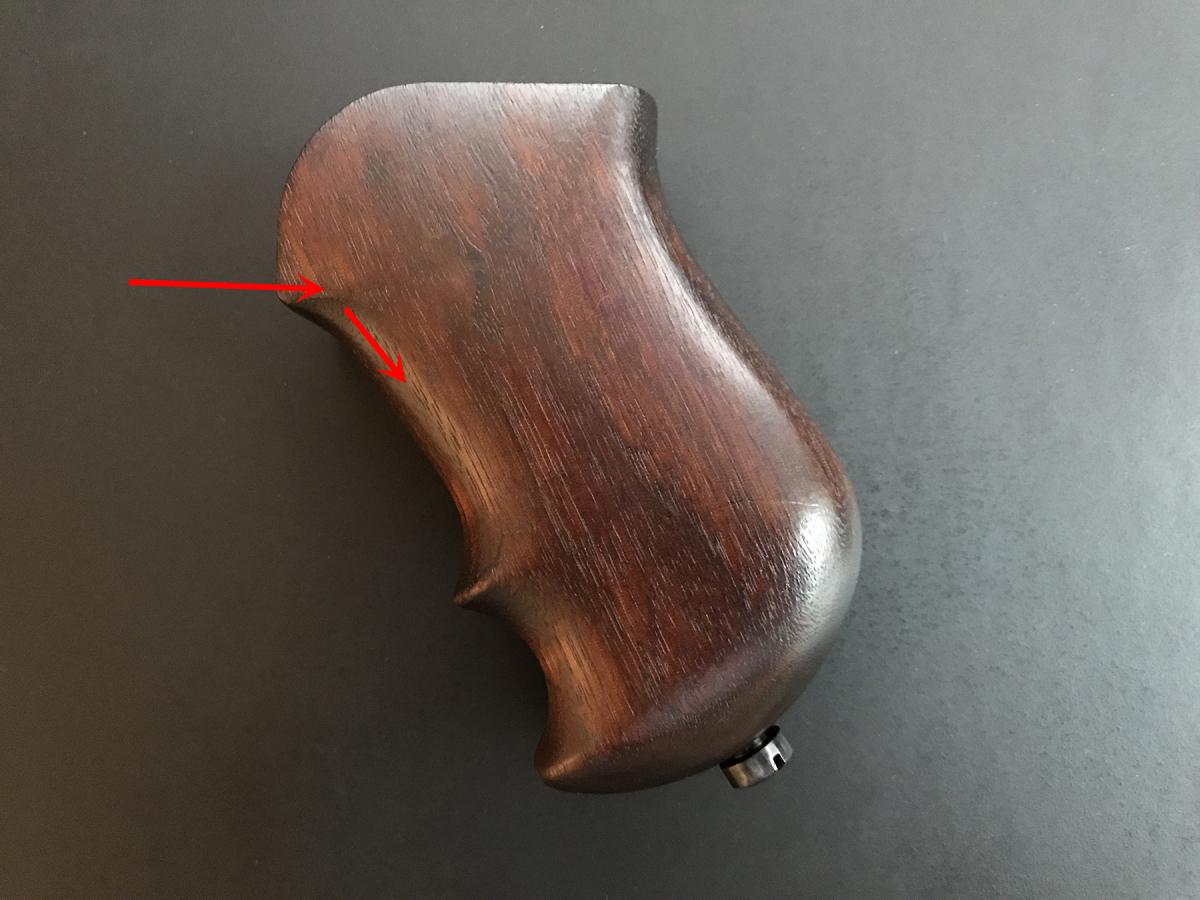

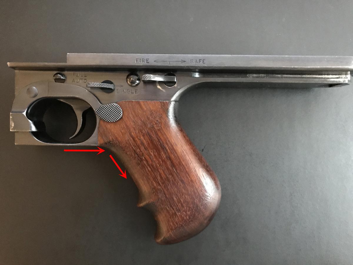

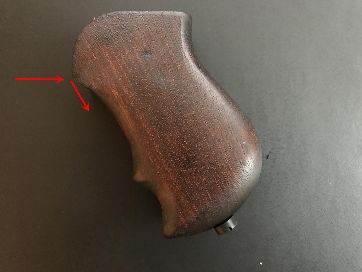

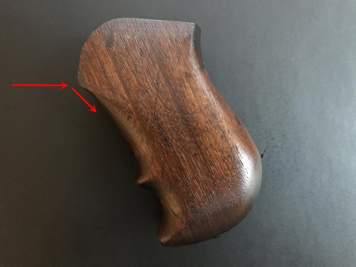

gijive Posted May 24, 2017 Report Share Posted May 24, 2017 (edited) Here are some pictures of various grips, including the tell-tale way to spot a Colt grip immediately. All Colt grips I have ever seen share the same unique characteristic. Notice Colt grip meets the bottom rear corner of the trigger guard, starts straight back before curving downward at approximately a 45-degree angle. Early Colt grip, notice the smaller size. Later Colt Grip. WWII Dittenborn Grip, notice where the grip meets the bottom corner of the trigger guard and curves downward immediately. Dittenborn mark. WWII Savage Grip, same characteristics as described on Dittenborn grip. Savage mark. WWII Strombeck-Becker Grip, exhibits the same characteristic as other WWII grips. Strombeck-Becker "M" mark. I didn't have an early Savage grip to photograph, but they tend to be smaller than the later Savage grips. Hope this helps distinguish a Colt grip from a WWII grip. Edited May 25, 2017 by gijive Link to comment Share on other sites More sharing options...

gijive Posted May 25, 2017 Report Share Posted May 25, 2017 Huggy, Thanks for the additional photos. That's a good photographic example of what I was referring to on the WWII grips. The grip meets the bottom rear of the trigger guard and goes straight down at 45-degree angle. No vertical line straight back for an eighth to a quarter of an inch before making 45-degree turn downward. Link to comment Share on other sites More sharing options...

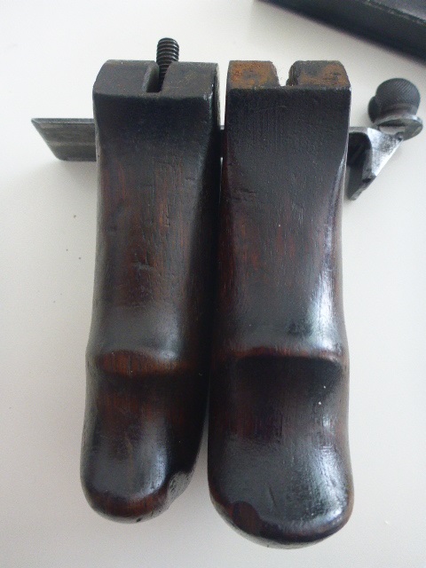

Roland the Thompsongunner Posted May 25, 2017 Report Share Posted May 25, 2017 Here is a picture of my colt grip and my early Bridgport made 1928A1 gun. Link to comment Share on other sites More sharing options...

Joseph_T Posted May 26, 2017 Author Report Share Posted May 26, 2017 (edited) As always this forum its such a great, actually the greatest source of informations...!! thanks!! Can i ask to Roland or Gi Jive to post a picture from the front of the colt grip Edited May 26, 2017 by Joseph_T Link to comment Share on other sites More sharing options...
Roland the Thompsongunner Posted May 27, 2017 Report Share Posted May 27, 2017 Here is a few more views of my colt grip Link to comment Share on other sites More sharing options...
